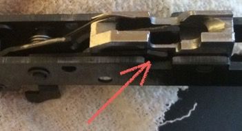

    Crap, the last shot hold open lever is broken. It didn't work when I got it, but it was so dirty and the spring was off. I just put it back in the receiver and still didn't work, had to take a different 60 apart to compare.
    Midway is out, Brownells is too expensive. Found one on eBay, buy it now with shipping $9.45. My $75 gun is now an $85 gun, then up to $110 because I also ordered the Williams 70742 fiber optic sight set. Oh well.

    The replacement last shot hold open lever arrived along with the Williams fiber optic sight set, so the 60 is back together.
    There must be 2 styles of lsho levers, my broken one was held on with an E clip where it passed through the side plate. The post of the one I received is shorter where it goes through the side plate. It's in there, but not held in place with the clip. I had to trim the ejector/lifter spring a bit to stop it from rubbing on the lsho lever. It functions fine so I'll leave it.
