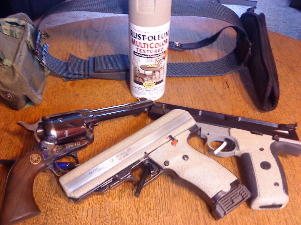

This is my Hi Point JHP 45. It's painted with the paint seen, and I sprinkled very fine sand into the primer coat on the grip.
